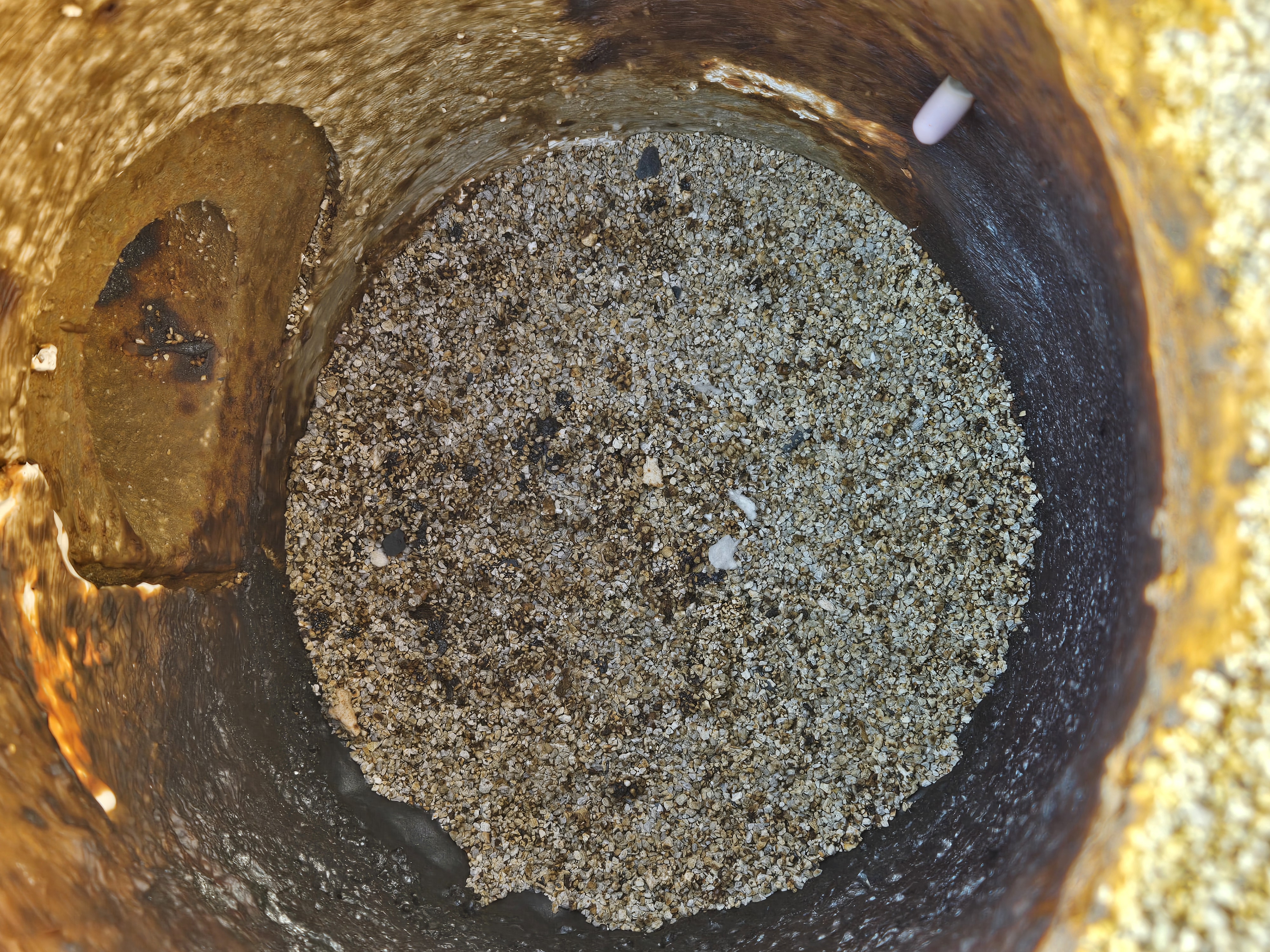

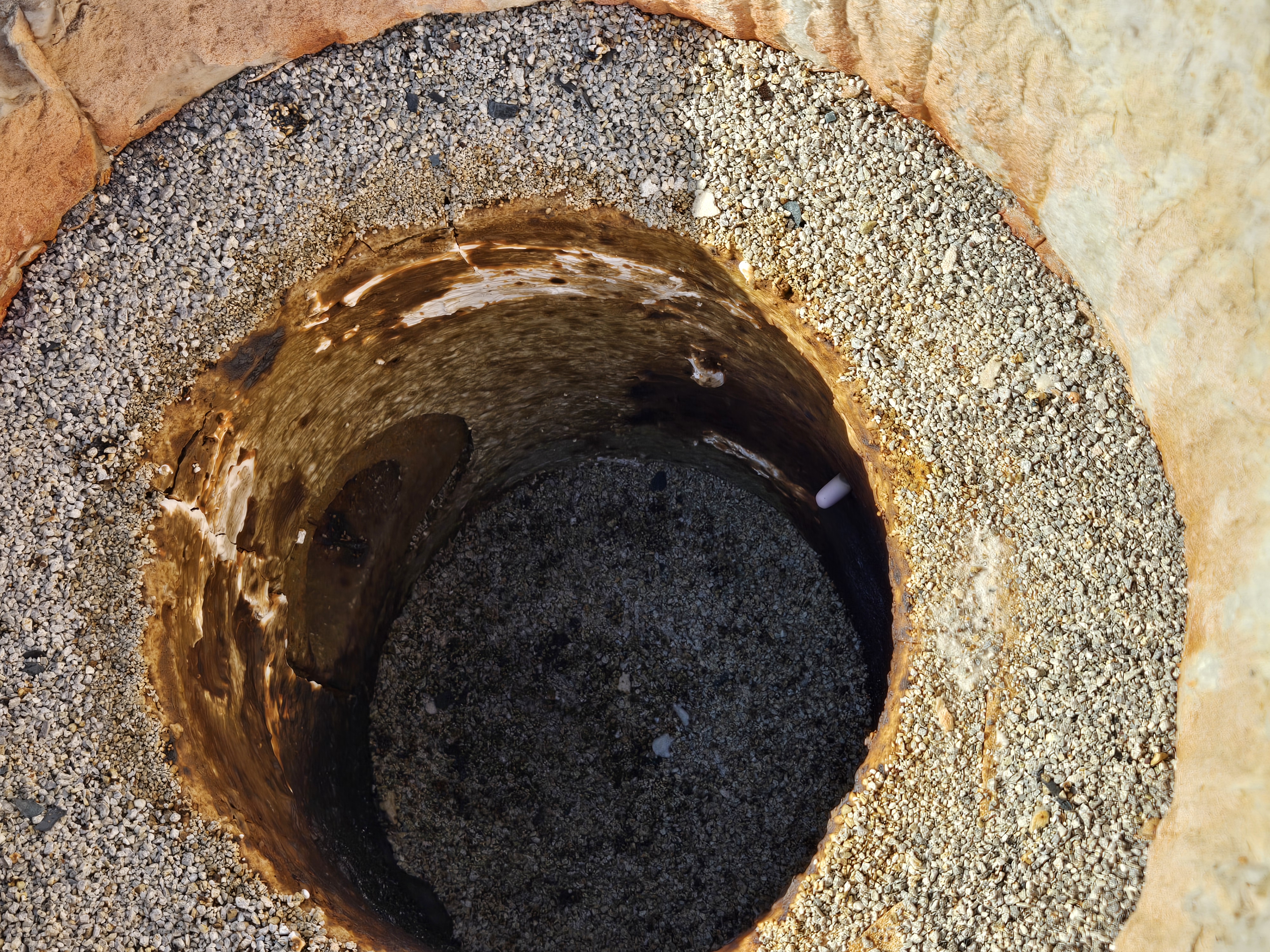

Quote from Jacob Christian on November 30, 2025, 1:18 pm@notfeanor, No problem! I use something similar to this: Ceramic Grog
I have it in something that is 3-5 mm particles. I put about a 2-3 inch base, smooth it out and then the plinth and crucible on top of that. The crucible and plinth will never stick to the bottom, just the grog. Then you can pull the entire thing out and just wipe the grog back in. I went to a local ceramics shop and got a 50# bag for about $5. It is extremely cheap when you dont have to pay shipping. This is after 20+ firings....
Here is the bottom of my furnace
And then the I also use it on the top to help seal the lid
