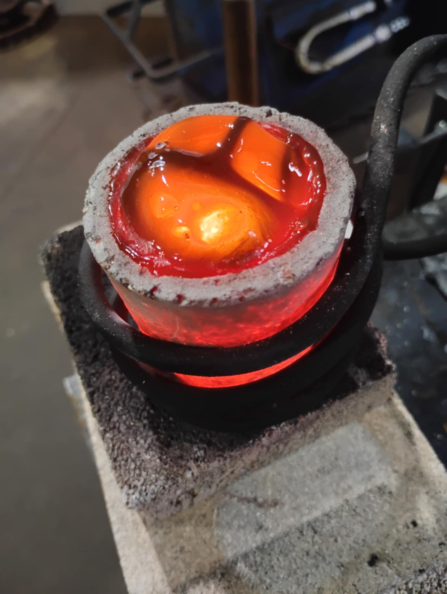

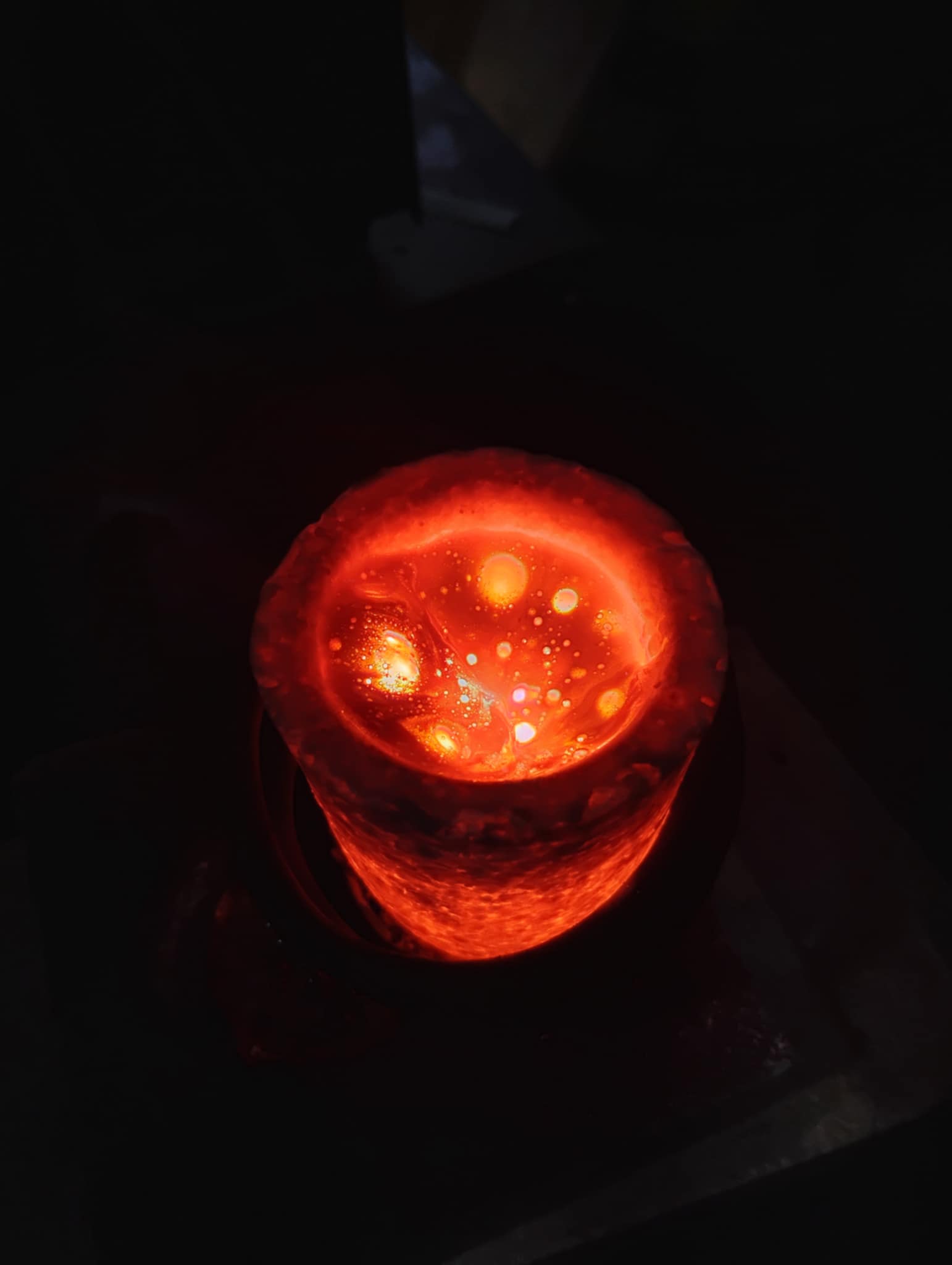

Quote from John Logan on May 4, 2025, 6:19 pmFirst wootzsmithforum calculator batch of steel. Pure iron, W2, and graphite. 300 grams total. No lid. Bottle glass. Aiming for 1.5% carbon. Beautiful melt absolutely mesmerizing to watch the dance of molten glass and molten steel as the magnetic fields of the induction forge keep everything turning and churning throughout the entire melt. For solidification I slowly turned down the induction forge input 50 amps every 5 minutes and watched the surface of the pool through the bottle glass slag (shade 5 welding glasses). The "moment" of solidification looks like someone drops a square of cloth on the pool as a field of crisscrossing lines spread across the surface. Absolutely beautiful.
Continued my slow downward ramp through solidification until I could see no further interplay between the steel and the slag, turned off the machine and buried crucible et al in vermiculite to coolHad so much fun decided to try a second run with clean cast iron (unknown alloy assuming around 3% carbon), pure iron, and the tiniest chip of lathe tool carbide. 300 grams total. Same procedure as above
I will roast these later this week and see where I end up!

Quote from Jacob Christian on May 16, 2025, 5:40 pmThis is awesome John!!! I like how you added the slow cool through solidification! That was something Brent and I were playing with. That slow cool is fairly crucial to shoving the excess carbon to the grain boundaries.
We also contemplated about casting a crucible with refractory and integrating the copper coils within it. That would then also allow you to wrap a bunch of ceramic fiber around it in an attempt to get it to cool even slower!
Keep us updated, I love seeing this!

Quote from John Logan on May 16, 2025, 7:04 pmMy kiln is down, darn pid is toast so just got these roasted the other night during open forge. Now that I have some of the super secrete stuff from the store did up a couple more melts of random concoctions (totally unscientific) just to play with things.
One thing I did want to note I tried instead of ramp down with the induction, this time I placed the molten crucible in a coffee can lined with 1 in Kao wool that I preheated with a torch. While the top surface of the puck looks better and is more jeweled, there is a good amount of prosperity just under the surface... So induction ramp down has some merits letting the gas escape. Maybe a hybrid method next? Would you pull it just before or just after solidification?
Side note whacking on some really unusually hard steel I believe I may have broken a bone in my hand... Work continues of course but updates on hard steel may be slowed
