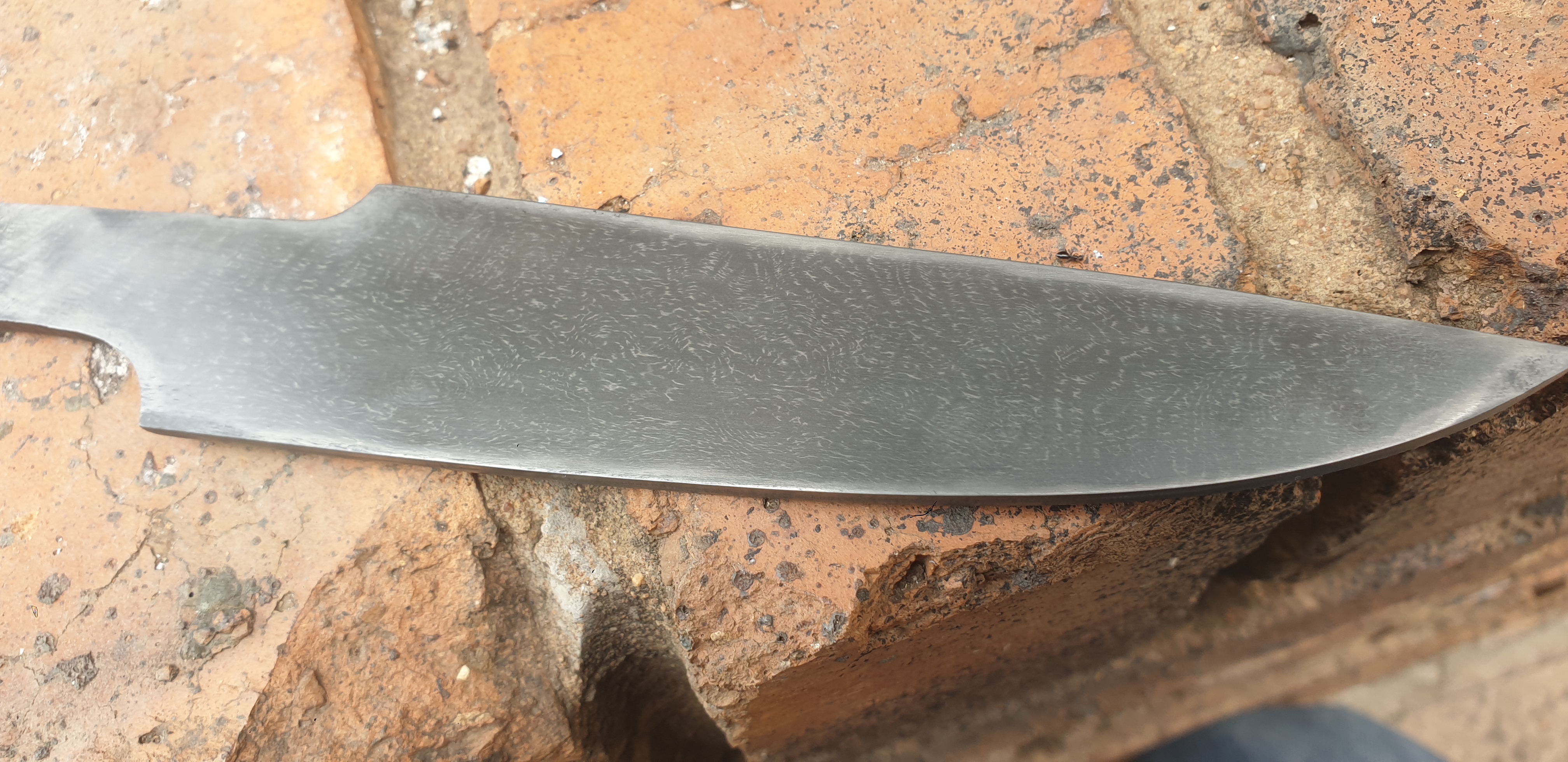

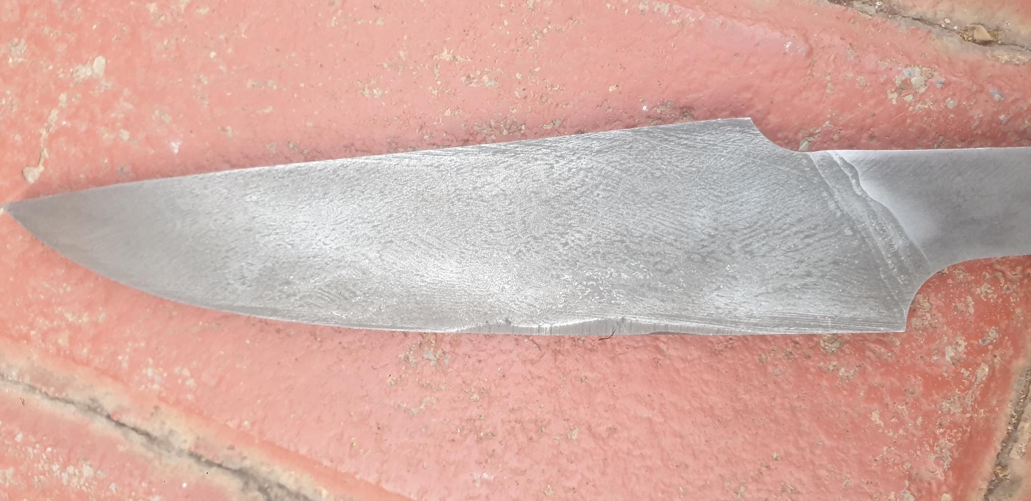

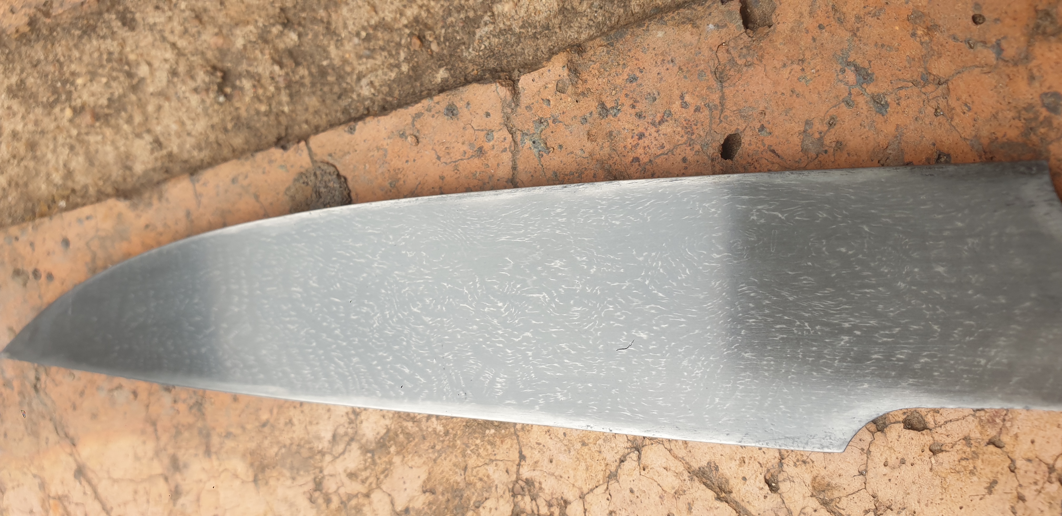

Quote from Raggedyman on September 18, 2024, 9:13 amSo I forged out my first blade, and although the camera used was terrible, the pattern looks ok-ish while wet. As sson as it's fry however, I have no idea how to get it to look like anything but a bunch of greyish lines.
Etched in Nitric acid, also tried ferric.

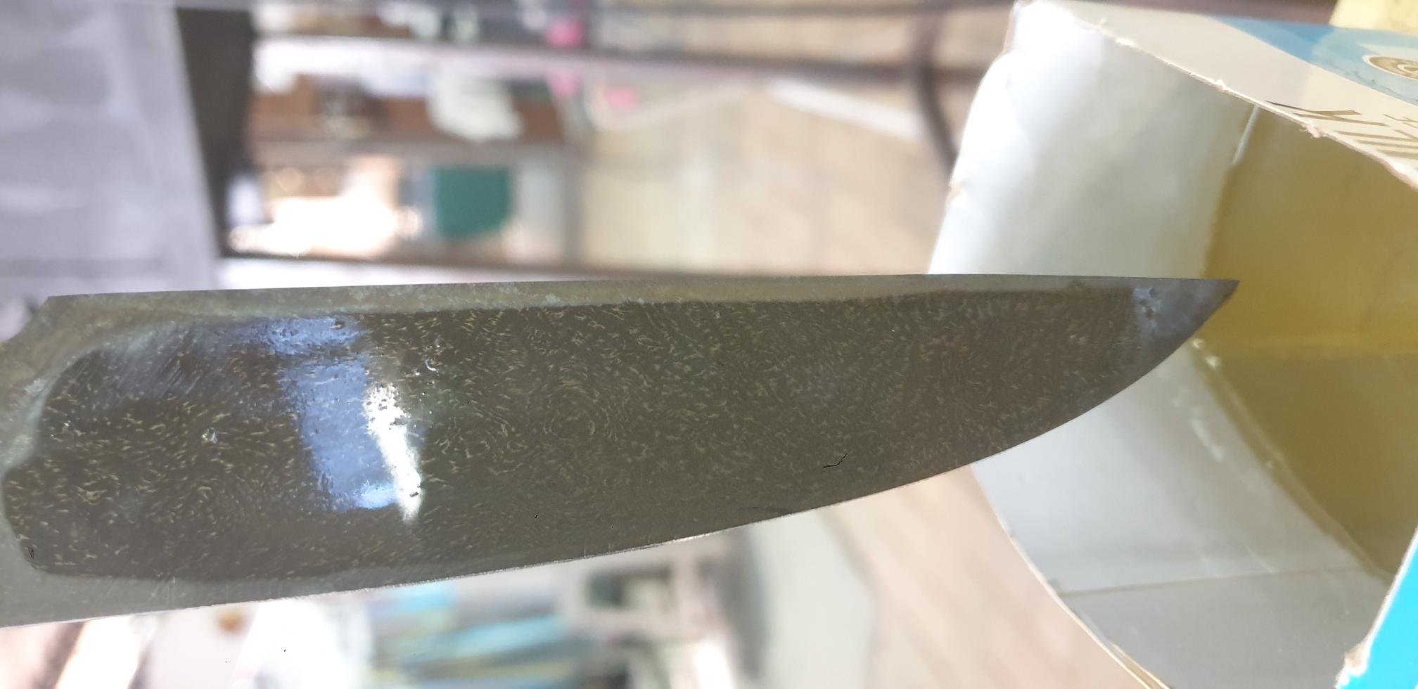

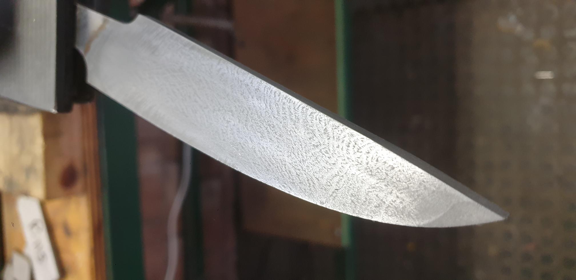

Quote from Raggedyman on October 2, 2024, 12:08 amThanks for the advice, much appreciated!
So having treated it with oxalic, here's the result. All in all I'm very happy with my first one. My patterning needs work, but it is visible carbide banding from dendritic formation at melt, so... wootz! Woo-hoo!
