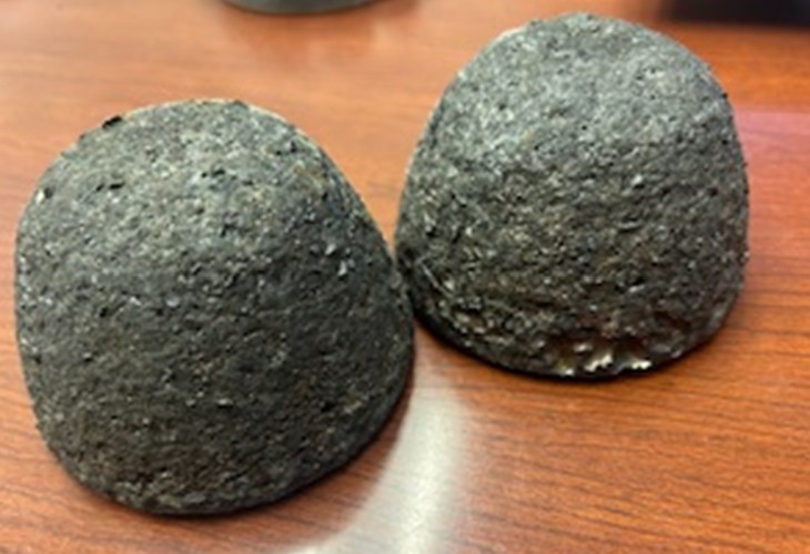

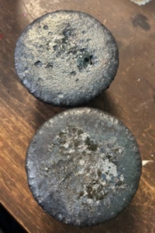

Learning Wootz, and gave it a try.
Newer here, been lurking, learning and finally gave it go.
Got two 2300g cakes with sharing the same recipe, 1.6 C for the target.
Not really sure if they are correct or useable but they sure do look cool.
Frist cake looks better than the other, the second had some spots fall off of it. Only known difference was running the furnace slightly cooler.

The picture is not blowing up very large but it does look like the bottom one is forgeable.
I cannot tell if there is a hole in the top one or not but that can also be forged into a bar and center cut out of it. Depending on your feed material, powdered steel vs chunks of iron, you should still get an adequate mixing of the molten metals.

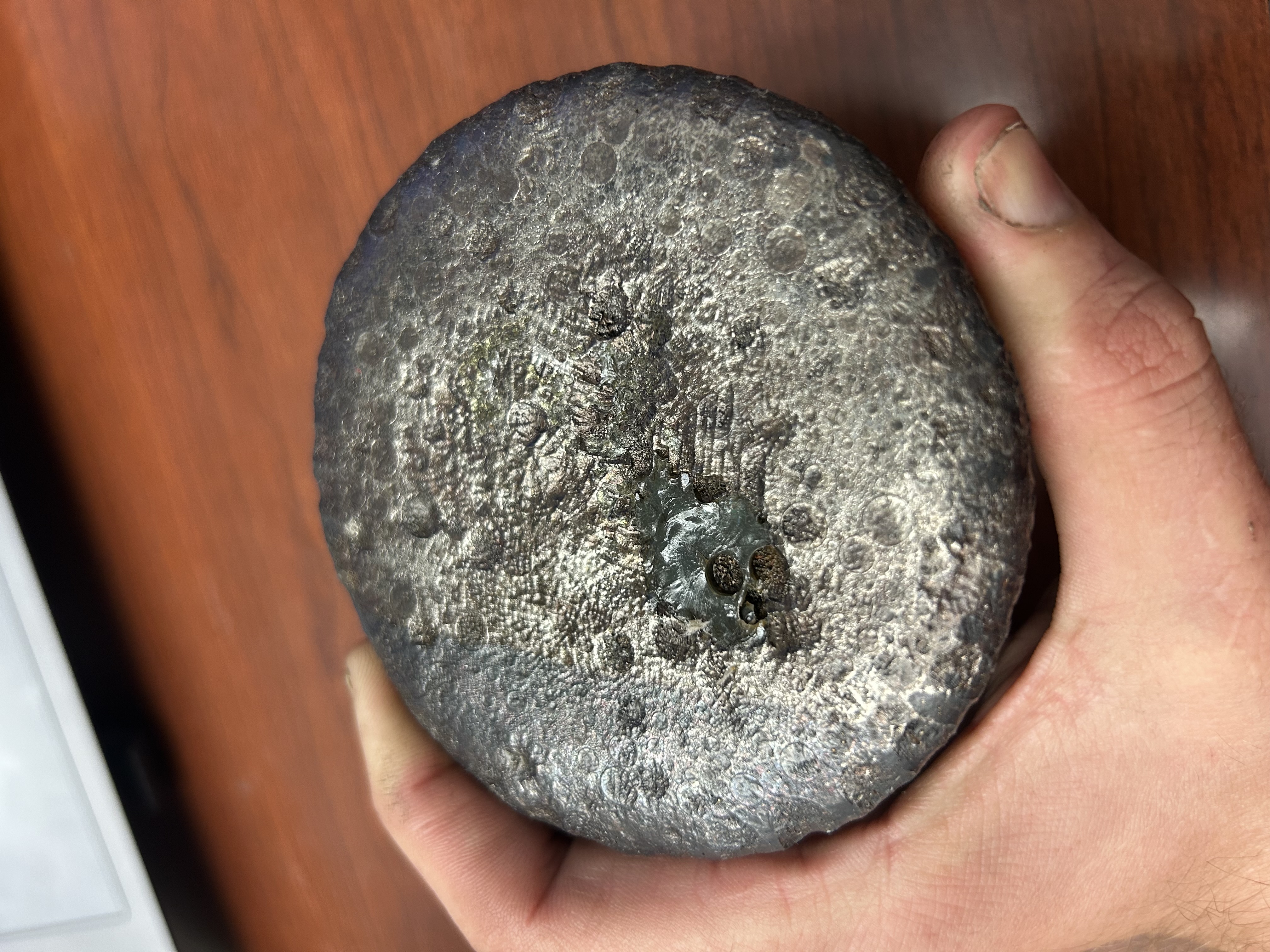

It has some glass still with a hole but I did see steel under it. But it is showing signs that it may not be solid there?
The feed was  iron chicks of iron.

Oh yeah, that looks fine to me. Now you should roast them at 1080C for between 1 and 5 hours. The longer, the better as it will break down more primary cementite and resist cracking much more.

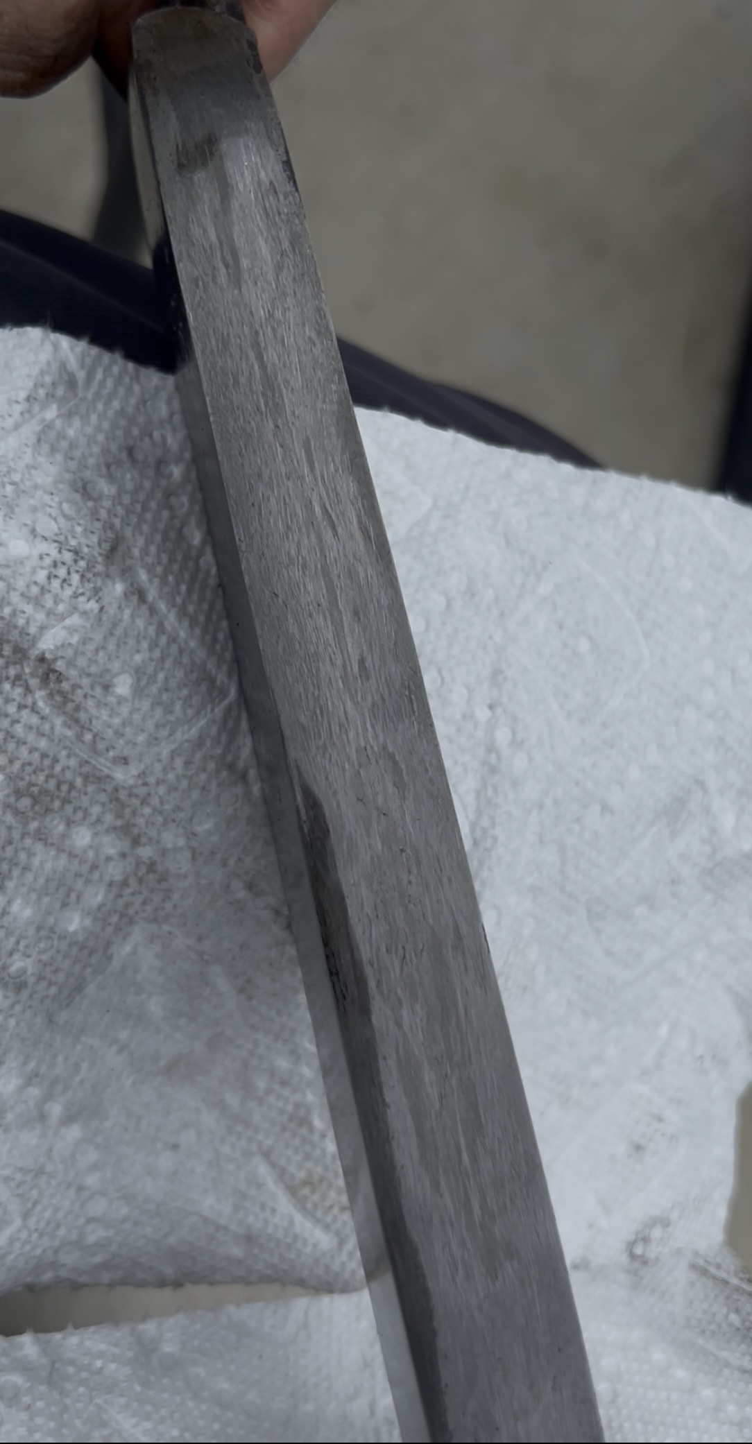

I have made some process on my attempt.
For starters, I have learned almost all of my feed was a bit too loose to really have a decent guess at my chemistry. Most notably I am much lower carbon than expected.  Hopefully still at least 1.2% C. But whom knows!
I proceeded to forge this out today and it went shocking well. It was slowly formed into a large bar and reducing temps during the last cycles.
I’ve had buds insist on etching it now, however I am aware I need to reform my carbides due beginning forging being above Acm.
Here is what is look like now! I’m sure there issues I don’t see or understand yet. But pretty neat and I’ll be forging it out to a blade soon.

@zbrockey This looks great! You are well on your way. Kind of hard to tell but you may have some primary carbides in there. Not a big deal, just a different kind of pattern. As far as carbon content, I would say that you are at least 1.2%, also a very difficult thing to judge lol....
No inclusions and no cracks is honestly a huge thing to get!

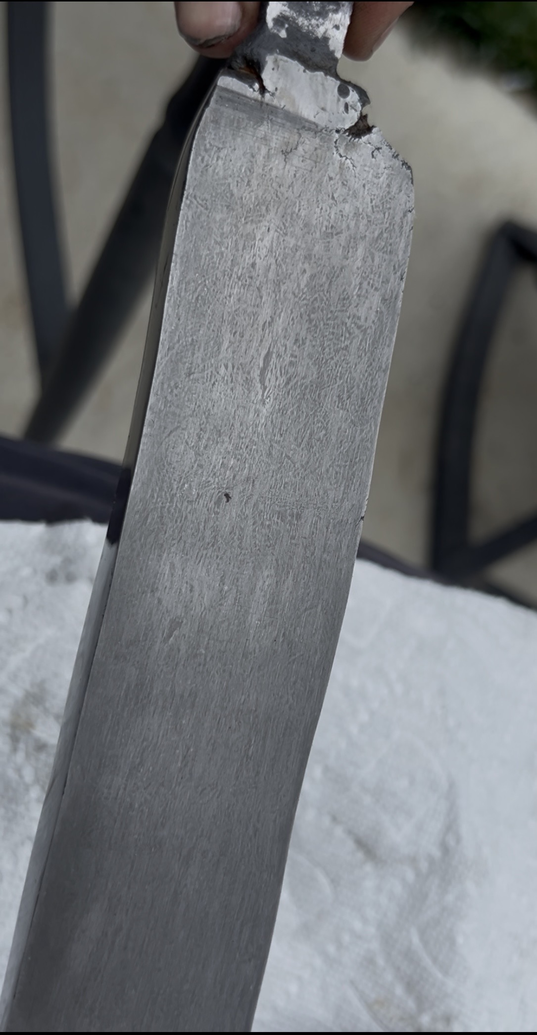

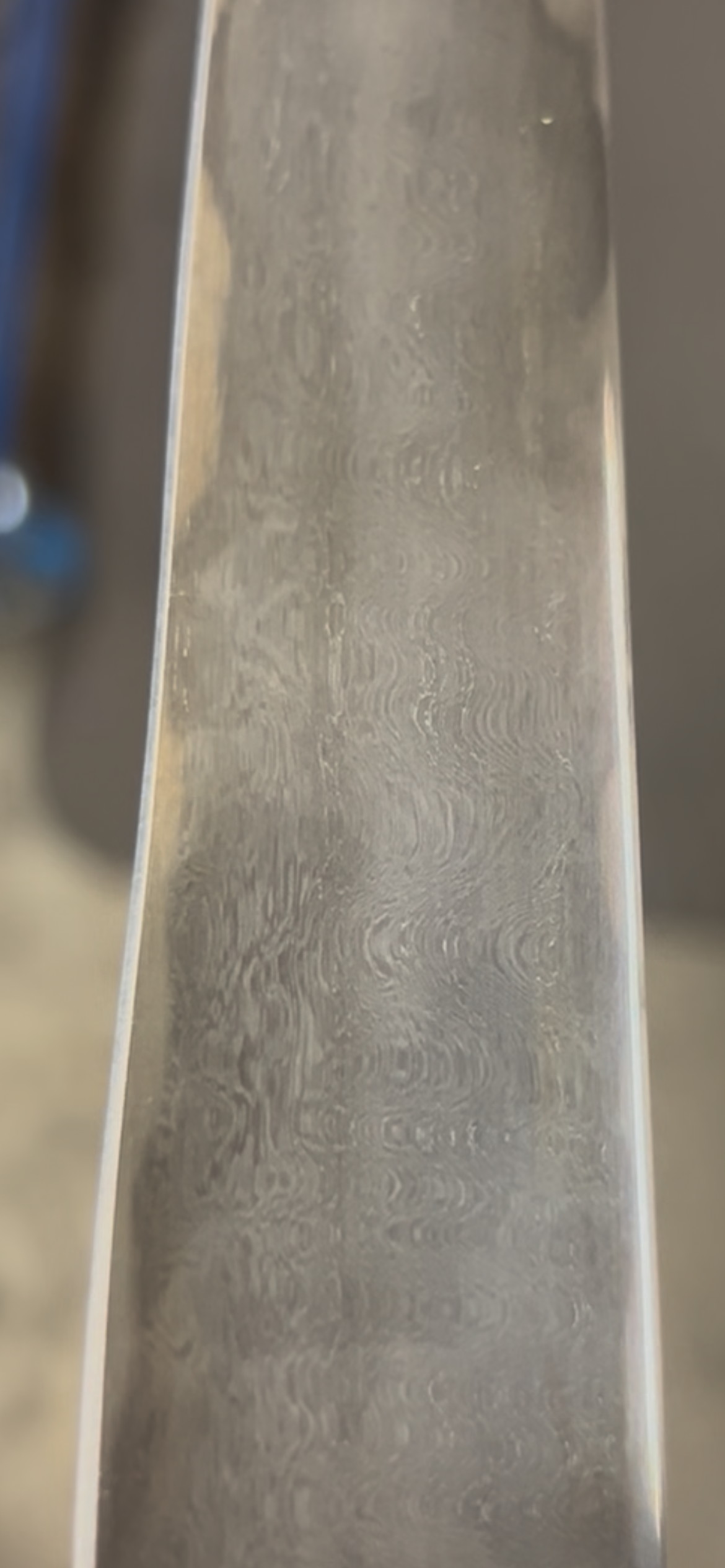

Thanks man, I actually already made the knife about a week ago from it.
I haven’t really learned how to examine the pattern or carbides yet. For the carbon, I have reached out to others they have all said it appears I’m on the low end of carbon. Had some mix issues that are being adjusted.
But it still worked out pretty decent. Here is the a close of some of the patterning.

Well as far as the carbon content goes, you have to be well above 1 % as the eutectoid point is around .8 % carbon. I said likely 1.2% when it was only in bar form and now that I see that blade, definitely around 1.2% maybe even a tad higher. Remember, the steel can also pick up carbon from the crucible.
Any carbon above the eutectoid point is stored as cementite and it looks like you have a decent amount of CM.
Great work man! I am very happy to hear that your first ingot resulted in a successful blade!!
