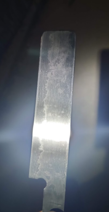

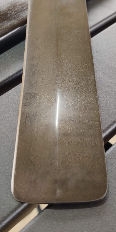

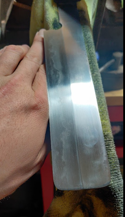

If you use oil and quench the entire blade, remove for a second and then submerge again, you will likely get a ghostly auto-hamon on the blade. It is very interesting but usually not defined enough to look too great. Below is an auto-hamon on a nakiri that was achieved using the aforementioned technique. In the pictures you can also see that the etch is much darker where the hamon formed. This blade had a bit higher amount of Mn which helps in hardening. Unfortunately that Mn also chokes out the wootz pattern slightly.
