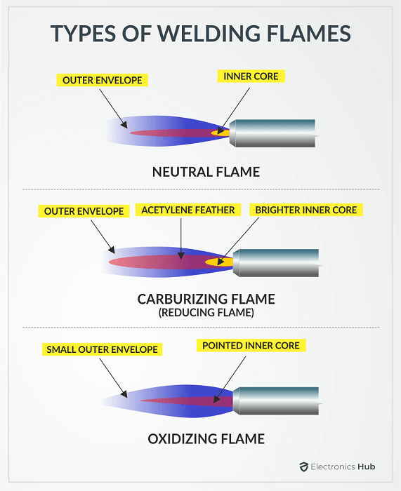

- To melt the ingredients I will be using an oxyacetylene torch which reaches temperatures of 3,320 °C at the tip of the flame. NOTE: You will want to make sure that you are using a carburizing flame on your torch so that you do not oxidize any of the iron. See the picture below for reference.
