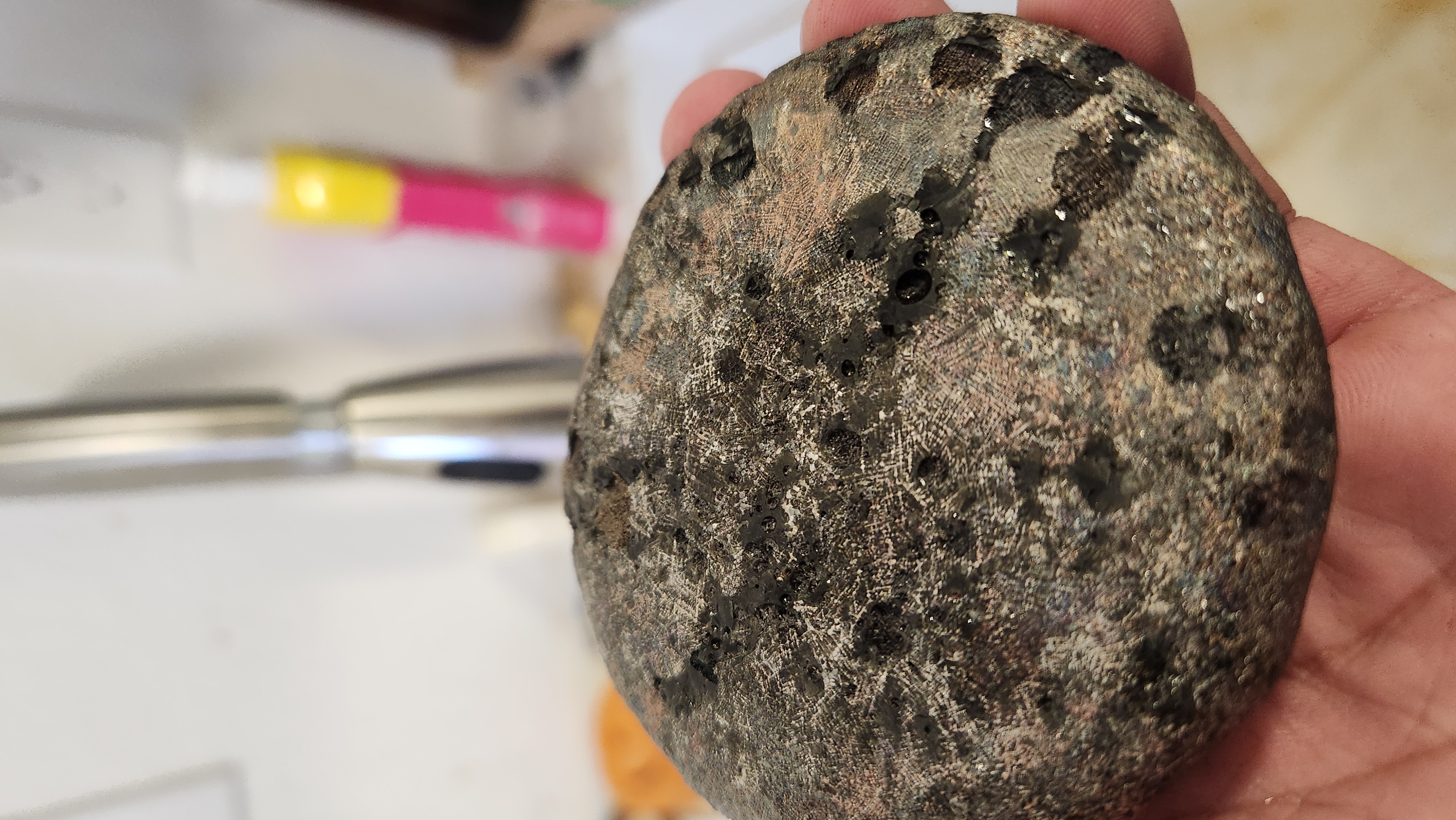

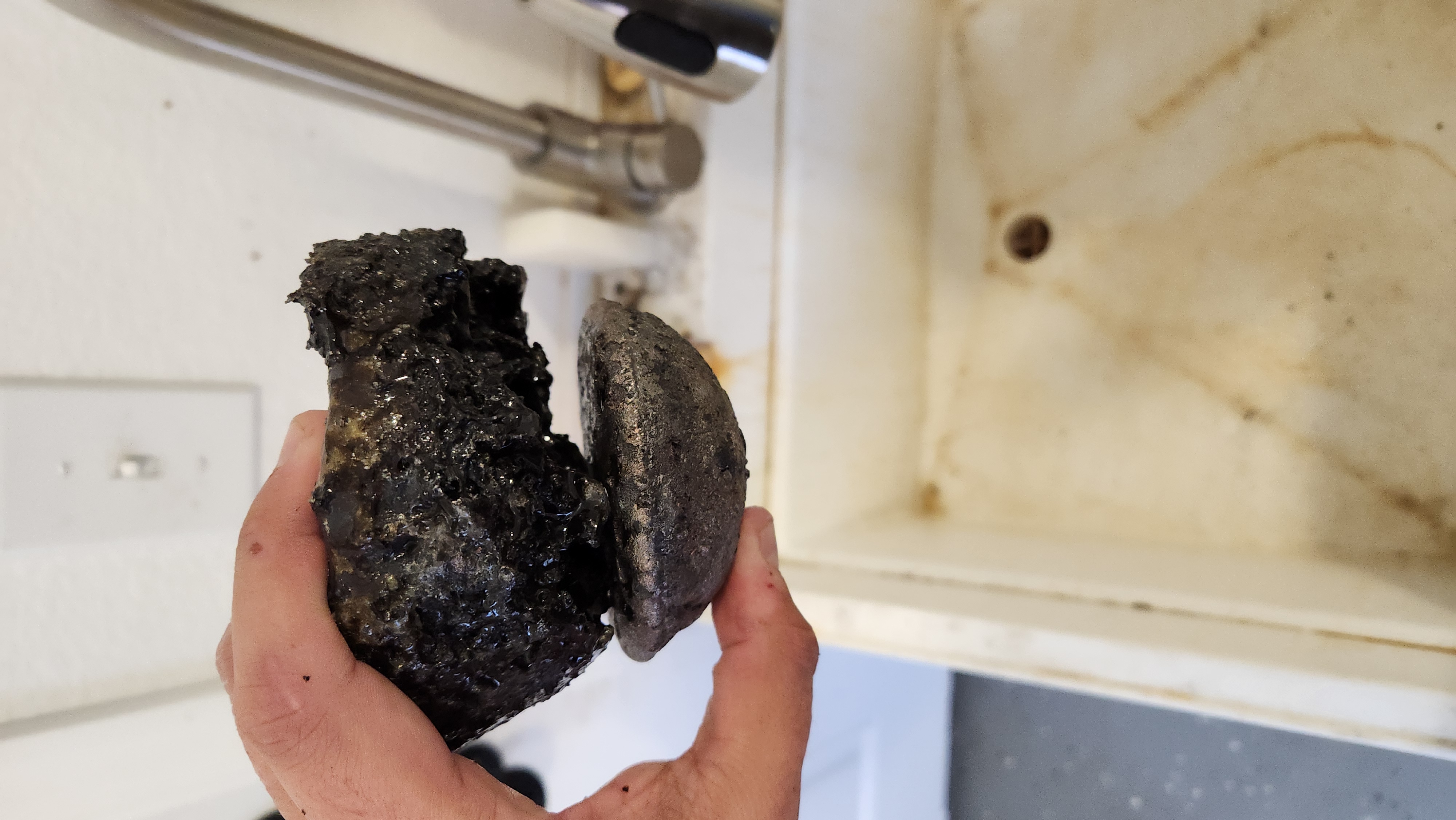

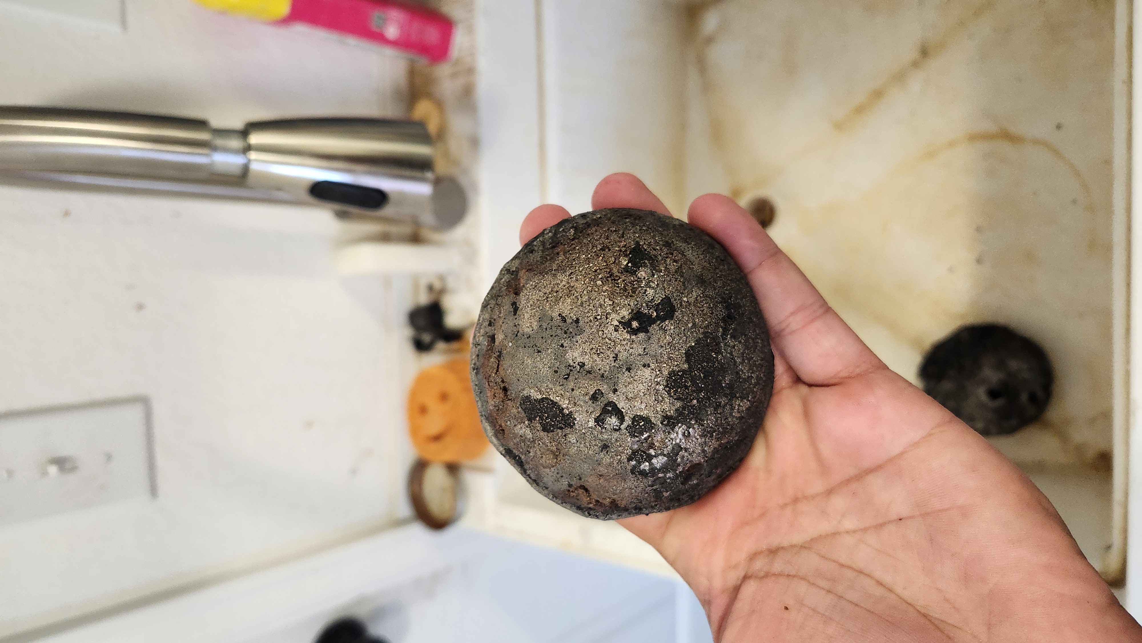

Thoughts on what happened?
Quote from Cody Bigelow on June 13, 2026, 3:04 pmGood afternoon yall, yesterday I had a smelt that I redid this morning because I found i had left behind some 1095 in the vinegar bucket, so I tried to resmelt and what looks like what happened was there was a gas build up that couldnt escape, but I could be wrong, thoughts/experience with this please?
Quote from Jacob Christian on June 13, 2026, 3:17 pmWhat is the top piece? Is that your slag layer or unmelted iron?
Judging by the ingot surface, it looks like you either have extremely high carbon or extremely high CFEs.
Quote from Cody Bigelow on June 13, 2026, 3:23 pmI think the top piece is a mix of both, so I'm guessing the bottom puck didn't absorb todays melt, which was just the high carbon steel that was supposed to be in the initial melt, and glass. What is CFE? I kind of doubt its extremely high carbon since the initial melt was calculated to be less than 1.0 carbon from what the forum calculator said, but I did add about 30 grams of carbon to todays attempt so it very well could be.
Quote from Cody Bigelow on June 13, 2026, 3:25 pmNever mind on the CFE, found some info on it. Very well could be since i used a mix of 1095, w2 and 01 with mild steel
Quote from Jacob Christian on June 13, 2026, 3:29 pmAhh I see, it could be a bit of both carbon and CFE. W2 and O1 are both pretty high in V, Cr, and some others.
Is this a coal melt? That could explain why the bottom ingot looks pretty good and then the stuff on top did not get hot enough to fully incorporate. The finer your starting material is, the faster it will become a liquid.
Quote from Cody Bigelow on June 13, 2026, 3:33 pmits a propane melt, Its safe to say I should have cut the pieces into much smaller bits. I ran the furnace longer today but seemed like it didn't get as hot as yesterday, but I didn't see much deterioration. Should probably get a hardier set up
